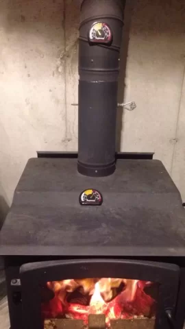

Good morning so I think it was the wood because I bought dry wood from lowes and its working fine and im getting radiant when I shut the air flow 1/2 way with the door shut and its going good. Its only 50 degrees here on long island so im not filling it to the top but .......I just wanted to ask you where do you put your thermometer on the stove because even when it was roaring pretty good this morning I couldnt get it above 300deg also do you ahave a specific way you load this stove that works for you?
this is after a hour or two haven't added much more due to it not being too cold out right now

I'm glad you worked out the wood issue. Poorly seasoned wood is the #1 problem new stove owners seem to face. Unfortunately a lot of wood sellers have no problem lying and telling people that the wood they sell is seasoned. Hearthstove recommends putting the stove top thermometer on the top center of the stove.
Looks like that is a stove top thermometer on the pipe and that is double-wall stove pipe. If so, the thermometer should be used on the stove top and the stove pipe should have a probe thermometer installed. Surface temperature reading on double-wall stove pipe is not useful and can be misleading. Condar makes a good probe thermometer.

I was going to ask if that was double wall. It's a lot hotter inside that pipe than that is saying even if its single wall. Doubly so if double wall.

well that makes sense thank you for the info
Once you get dry wood and a probe thermometer, try to keep the flue gas temperature below 800ºF. Use the stove pipe temperature as a guide to turning down the stove air in increments. You will have to judge what works best for your flue and stove, but maybe start by turning down the air half way when the flue temp reaches 5-600F. Then let the fire regain strength and turn down the air again when it is burning well. How far you can turn down the air will depend on the wood and the draft which will get stronger as it gets colder outside. Some people can turn it down all the way and some can turn it down to around 3/4 closed.

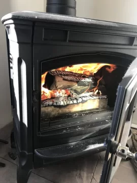

I have 2 of the same thermometers on mine, it's single wall pipe though. I've never bought firewood from a dealer before but I'd be very angry if I got 30+% moisture content advertised as seasoned wood. Because it's not. Semper Fi
