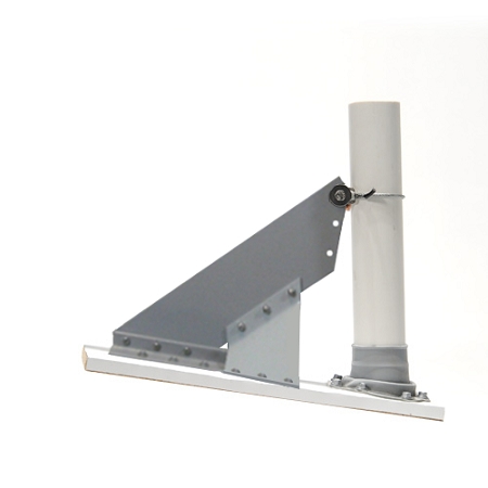

How hot do those outside seams get? I read those old threads with interest as I have supervent pipe as well. Also added one of these this summer
