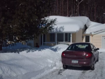

I've lived in the house now 4 years, I replaced the roof last year. The pitch is low I think around a 3, when I re-insulated the attic I also vented all the soffits with baffles and etc. I'm not kidding when I say I've thought about dragging the snow blower on the roof, I rake it or shovel it as needed! I have a german shepard/lab mix who I have found to climb the snow banks and hang out on the roof, guard dog with a view. I'll try to attach a jpeg, don't know whether it'll come out. this was a nice lake effect drop over night, the snow on the roof is waist deep, the drift over the garage was chest deep, about half an hour north they were getting 4-6 ft a night, every night for weeks.
Anywho, looked at PE's website at the Alderlea T5, very nice! Unfortunately no dealers close to here, still thinking Quad 4300,
going to go on lunch break tomorrow to another VC dealer who also does Hearthstone, see what they have to say. If the jpeg of the snow goes through have some jpegs of the interior of the house I'll put up.

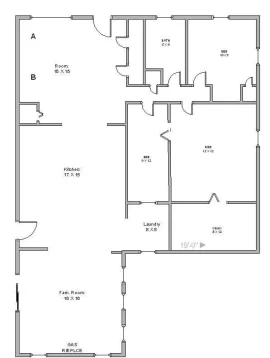

O.K., I'm not drinking the Kool-aid just yet, however getting closer. A little more info that I guess I was hiding. A friend of ours installed another friends wood stove so I would have "capable" help, although I use the term a little loosely. I 'm rather a perfectionist as need be, he's rather a let's get this done today I have stuff to do kind of a person.
So , I've attached a Word doc of the layout of my house, A and B represent places I'm thinking of placing a stove. "A" would be a corner install, flue would be more towards the front of the house with a low "dormer" type peak on the western side of it where the wind blows out of. In the winter it blows pretty good, If you look at the JPEG of an earlier post of the out side of the house it would be in the corner by the bay window.
"B" would be going a little more toward the center of the house facing down the hallway to the bedrooms. In the outside JEPG located similar to where the power lines/phone lines attach to the house but at least 2-3 ft in from the fascia. I can probably throw up a better picture of the roof and peaks without the snow if it helps.
Again, give me the opinions on where you guys would likely place the stove. Also, last year I tore up the carpets in the room and laid down laminate flooring, so I 'd like to get some advise on what kind of Hearth pad I can build over it.
