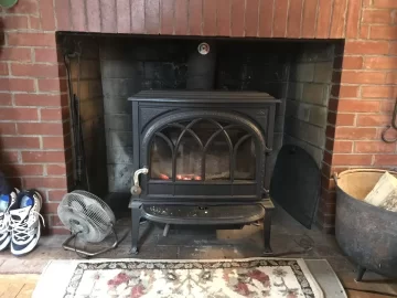

I have a Jotul F500 installed in my fireplace. It works great but is is the older version. Dimensionally this should work Depending on the size of your hearth. No matter which you choose get their manual online first and check all the clearances. It was close with my Jotul. My particular set up makes it tough to clean the chimney but I hire it out. That is something else worth thinking about when you make your decisions.

Would you mind sharing a picture? My fireplace is all masonry/tile so the only clearance I need to worry about is the hearth. I had a chimney sweep out last week who cleaned and inspected everything. He does stove/insert installs as well, and said I'd just need a heath pad/rug for spark/ember protection in front but otherwise was good to go. If I go with the F500 it would be a little tight for sweeping, but if I get the short leg kit that would allow a little more room.
Make sure there is room for the side door to open. The F500 is primarily a side-loading E/W burner.

Yup! It's going to sit on the tile hearth with the back slightly set into the opening. The side door will be operable. Thanks for the reminder. I've read that the front door tends to dump ash everywhere.
