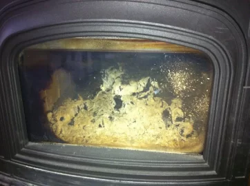

I will reload before I go to bed and I will get you a pic with a fresh load.
Here it is on med-low. This was loaded at 8 am with a partial load of cherry. It's in the low 20's here. The other pic is on high less than 5 minutes after the low picture.
The glass hasn't been cleaned for about 2 months. It has the cleanest glass on average, of any stove Ive ran to date. It runs on medium to medium low most of the time and I'm Heating 2200 square feet.
