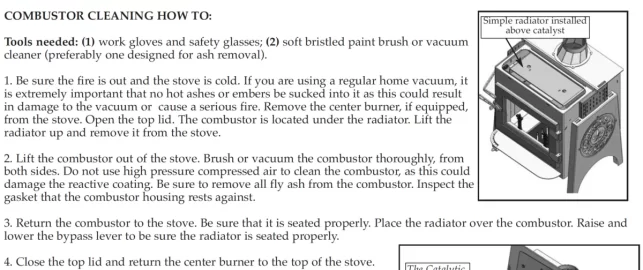

It's Summah in Maine after my first year with the Ideal Steel. Wowza that thing kept us warm..and sometimes hot and happy! Actually if the temp outside ever reached 40 it was too warm to start the stove...but that's for another post.
The instructions on cleaning the cat are a little bit thin, any tips for a Summer deep clean that won't have me accidentally damaging it?
