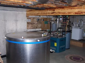

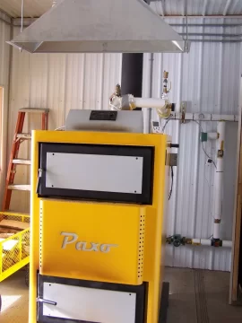

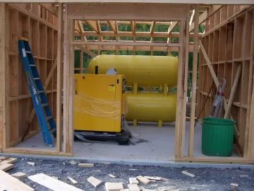

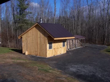

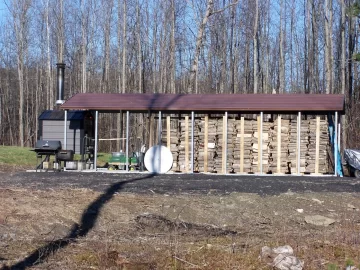

Corey,, I can tell you I had an outdoor wood boiler for 6 years,, heated my domestic hot water and house,,, 10-12 cords of wood,,,, got sick of processing all that wood every year,, sold my boiler and built an outdoor boiler building, installed a Paxo 60 gasafication boiler 1000 gallons of water storage in the boiler building, pus 600 gallons in my basement,,, big money investment, still burned 8 cords,,, had to worry about corrosion in the system, keeping the circulators running if the power went out,,ugg !! Now that we moved to our farm,, two simple wood stoves in the house, one cook stove and one regular Cat stove.. So much simpler ... power goes out, nothing changes.. Half the wood usage,, and no boiler water to maintain....I like having things simple again...Those OWB's gobble wood,,, don't let anyone ever tell you different... People will never admit but your a slave to them,,, once filled with water, your it everyday to keep it going or you lose your investment...unless you can back heat with your main heater in your house in an emergency,,, that what I did......Just giving you a heads up to what I've been through..I actually got two years ahead for my out door wood boiler at one point... 24 cords takes up a lot of room,,, then the sad part is looking at all that wood , knowing in 2 winters it will be gone verses 6 with an inside stove... Makes you think about your time....I learned my lesson;)
Charlie
[Hearth.com] Cat stove or outdoor wood stove[Hearth.com] Cat stove or outdoor wood stove[Hearth.com] Cat stove or outdoor wood stove[Hearth.com] Cat stove or outdoor wood stove[Hearth.com] Cat stove or outdoor wood stove
Wow - can't beat the suggestions from someone that has run all three styles. OWB, Gassifier and wood stoves. Thanks for that, Charly.;)
Just trying to save the next guy a lot of money.. I had a wood stove before and now that's what I'm back to burning...Simplicity at its best...and a lot less wood... Plus like said earlier in this post,,, you get to enjoy viewing your fire.... And best of all,,, when the wind is blowing with below zero wind chills,,, no trip outdoors to load the wood boiler... even though my gaser was in a warm shed,, you still were heading outside to reload..I like reloading now with my socks on;). Just the money in quality underground insulated pipe puts you in the wood stove range.. Keep it simple and fun!
