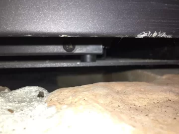

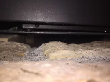

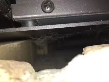

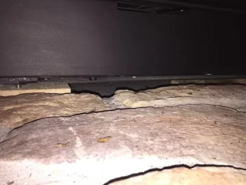

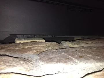

I just got done re-reading all of the pages in the ci2600 post for the second time. I have posted a few times in that thread but have not received responses. I am still not holding consistent cat temperatures. I may get to 800 but I have never got it any hotter. I have burned it about 7 times now and today the temp is in the low 40s. I have it loaded fairly full about 3/4 if I had to guess. [Hearth.com] Cat temp never gets very high[Hearth.com] Cat temp never gets very high[Hearth.com] Cat temp never gets very high[Hearth.com] Cat temp never gets very high[Hearth.com] Cat temp never gets very highBut once I put the fan on and close it down the temps drop down. After a few hours I am at 500 and I know it will continue to decrease. The unit is on one side of the house and chimney is 25 ft high on the outside of the house. There is no insulation other than all the firebrick around the unit and the liner is not insulated. What I noticed is that the installer lifted the unit in the fireplace and placed it on fire rock and there is an open area underneath the fireplace. I took pictures so you can see what I mean but do you think this could cause my issue of the temp not staying up? Thank you for any advice you can provide.
Of the area underneath the insert in the fireplace showing how much area is there.

I guess I am trying to figure out if I shouldn't have that much open area and if that is causing my issues of not getting a high temp like I see others getting for periods of times. Should I put roxul there?
Got ya. That shouldn't effect the cat temps. Why was the liner not insulated? I also assume there not a block off a block off plate? Is it sealed off and insulated at the top?
Since this is a flush insert I need the fan to throw the heat off. I just didn't expect it to cool it that much.
They did that because your hearth is so rough, the unit needed to be lifted as high as the highest stove, or chisel the stones down. Air should not be making its way out of the top of the chimney, but I'm guessing it is.
The liner just fit up the fireplace as it is so there was no room for i insulation. There is not a block off. Not sure about the top
It's very uncommon to not be room for insulation in a fireplace flue. It happens on occasion though..
I have a feeling my installer did not know what he was doing to do this correctly. It appears I need to insulate the liner and have a block off plate installed?
Air will be pulled right past the insert and out the top, even more so with raised off the floor like that if it's not at least sealed and insulated at the top. A block off plate isn't required with an insert, if your bid didn't show one, then it's not necessarily wrong. It will greatly improve performance though. Any pictures of the cap?
