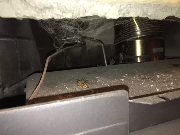

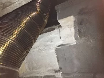

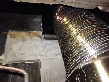

You installer doesnt know what he is doing the connector on the bottom is on wrong the liner should slide into it not over it. the liner is not attached to that connector at the bottom. He kinked the liner as it comes through the damper and yes it needs insulation and some sort of block off plate for sure. I am also curious why there is so much dirt ontop of the insert already did he even clean the chimney first?also took pictures of inside the fireplace and can now see how the liner goes up the fireplace.
I guess I definitely need to insulate the liner and install a block off plate.
Is that first picture the cat temp probe?
wow! That's why I wanted to see a pic of the top. Most often, a quick look at the components and the way they are assembled will tell you a lot about the installer.You installer doesnt know what he is doing the connector on the bottom is on wrong the liner should slide into it not over it. the liner is not attached to that connector at the bottom. He kinked the liner as it comes through the damper and yes it needs insulation and some sort of block off plate for sure. I am also curious why there is so much dirt ontop of the insert already did he even clean the chimney first?
I was wanting to see how it was finished out at the top.
I understand, sorry you are dealing with the fall out..The installer will never do work at our house again due to numerous issues with this whole thing but now there is nothing I can do about it but fix the issues.

If you can swing it, I think it's necessary to have someone reputable out to pull the liner, insulate it, reinstall the fittings properly, and install a block off plate. I would expect to spent around $500 for the work.

What is that in the first picture shown? Looks like a thermocouple going into a sardine can....
Yeah, that band clamp is supposed to be tightened onto the liner, then there are screw holes in the flue collar of the stove, probably covered by the band clamp now, correct? There's a better pic on page 2.wow! That's why I wanted to see a pic of the top. Most often, a quick look at the components and the way they are assembled will tell you a lot about the installer.
I think you could, too. You just have to know how to read and follow instructions. If that installer was born in the last thirty years, chances are good that his reading comprehension skills are lacking.Hell at this point I think I could install it better myself.
 Of course, there's always something that comes up, that's why an experienced installer is worth the money. But I think you will be hard-pressed to find an installer that is as good as bholler and webby. I would try to get the certified guy...20 miles ain't that far...
We travel 40 miles regularly, 20 is just down the road!Yeah, that band clamp is supposed to be tightened onto the liner, then there are screw holes in the flue collar of the stove, probably covered by the band clamp now, correct? There's a better pic on page 2.

Check and see if that appliance connector is the same brand as the liner. That way, you know it will fit properly and work right. If you are going to dive in and attempt repairs yourself, read the installation instructions of both the stove maker and the liner maker. You may as well pull the liner and insulate it while you are at it, and make a block-off plate. It looks like it will be a long fall...you should have it done before it gets too cold out.I am going to work on fixing these issue as soon as I get some help to get the stove out.

I do not work for the company that made your stove. I think you should ask them. If you have a 700 or higher reading and then turn the fans on and it drops in temp reading, turn the fans back off and if the reading increases, it's the air hitting the probe.View attachment 187709View attachment 187710
Here is a picture when I took the faceplate off. The second one was where the hot air flows from the fan and you can see the probe in there.
I thought about if I could insulate that and see if it made a difference but didn't think of a can. Thank you. Can I leave it there if it works so I have accurate readings or will it cause harm?
