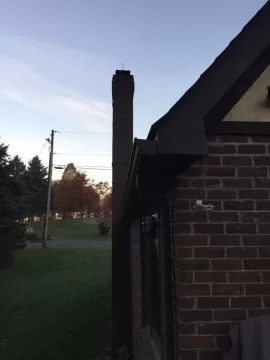

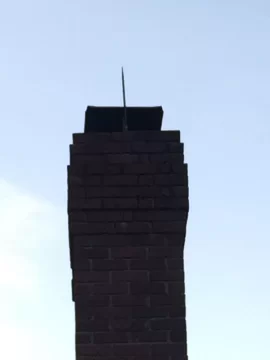

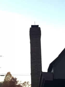

From the looks of the chimney pics, they may only have 12' of stack. Now, with 20' and an insulated liner and block-off plate, they probably
could run with the air closed, or almost closed.
