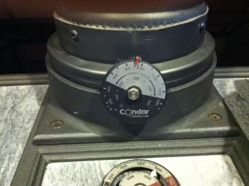

This is a Condar probe correct? Which one is it, the all black dial that reads up to 2000 or the new dial with the silver operating zone that reads up to 1700? Condar recently changed their probe to the later. I have both and I get a 100-300 higher reading with the older all black probe. I have tried calibrating them in boiling water and also with my smoker thermocouple which only reads up to 550 and have found the new probe to be most accurate at those lower temps but have no idea about higher temps.
I guess what I'm saying is there are two different types of probes out there and I'd be a little Leary off their accuracy without comparing them to a high temp thermocouple.
Sure is, the black one that goes to 2000 and actually, it's brand new, or just delivered on Friday from Condar. They must be getting rid of their old stock. I thought I'd try a new probe since I wanted to try the obvious first. I did not check for the correct length, which as it turns out may not be an issue. I think if I could afford to do it over again I'd buy a non-cat stove. I've not been able to make head or tails of the whole process, although when I do get it right I get great heat and long burn times, up to 14 hours.
Here's a pic of the new one with the silver face, it reads 1700 where the old black one read 2000. I think they recalibrated the new one because they found radiant heat off the stove was throwing off the readings at higher temps. We have done similar tests here on the forum and have found them to read a bit high as well.
Don't give up on your cat stove, you'll get her figured out. I wouldn't worry about your cat temps, I bet your 2000 temp is really only about 1700. 1000-1600 is normal operating temps with a full load.
Good info Todd. I will check mine out. I have the older style Black dial.

Okay so if you have followed this post some you know I received a new cat thermometer from Condar a couple of days ago and, according to some, it was their old style which may or may not read hotter than actual temps.
Yesterday I got up and my thermometer was reading 800. I says: "Hmmmmm.... I knows dey ain't much in thar fur it ta be dat hot." After all we were near record warm temps outside and I was letting the stove cool for some clean-out with record warm soon to be followed by record cold. An hour later it still read 800 and I says: "Dat ain't right dang it!" And I reaches over and pulls dat thermometer out and dat dang probe, it cool to da touch! So I call dem folks at Candor and wilst I'm adialin' dat thermometer goes "twang" and drops to 400! As I'ma talkin' to da man at Condar it goes "twang" again and drops to 200! So there asendin' me ah new one under warranty.
This whole thing makes me wonder 2 things; is there is any real accuracy to those types of thermometers and how much damage may have been done to the cat because of the faulty thermometer?
