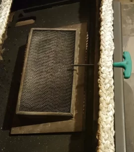

1. Using a drill bit and a micrometer it appears as if the factory hole is approximately 0.210"
2. The best reach I seem to get out of it length wise is 4'' (probe length). Any longer and the bypass will hit it during closing.
3. During operation, the probe may be in close proximity with the sled and stove body (see picture).

The first picture the bypass is closed, second picture partially open, third picture fully open.The tool in the picture represents the 4" probe.

The position of the probe tip in your pics looks pretty good, slightly over the edge of the cat. I like the tip within 1/2" of the face of the cat. A little further, like 3/4", will work but it will read slightly lower.
