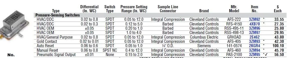

Check attached photo you will see the switches have a range for rating in water column(WC) This is what the switch is rated for, See below.
Lower number is when the micro switch closes. Normal stove vacuum must be great enough to pull the diaphragm to close the micro switch. Example for N/O contact: Open stove door, switch opens because of decreased vacuum. Control system stops feeding pellets.
Higher number is the switch safe high limit. Maximum safe amount of vacuum you can apply without damage. The reason for the high limit is the switch contains a diaphragm or some say bladder. Usually made of rubber. If you over pressure with to much vacuum you could rupture the diaphragm.
Thanks for the explaination. Good not to damage the stove. But it does add another layer in the process and to the time. Since I have a lot more time than money, I'll try to do it the safe way. "Better safe than sorry"
I just pull the hose off the switch. Just takes a second. While the leaf blower is sucking the soot from the stove its also cleaning out the soot that might have clogged the hose. Once every ton I pull the hose off the switch and blow air back thru the stove to be sure the hose is clear. A plugged hose will effect the stove.
