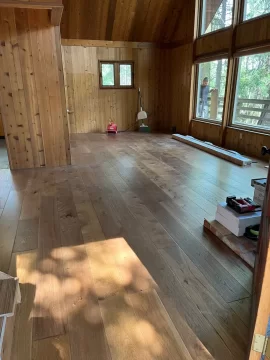

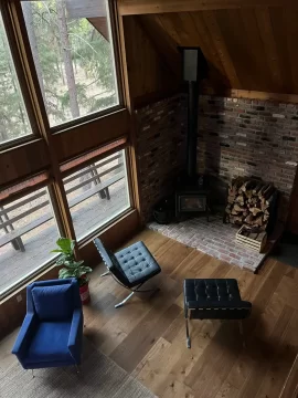

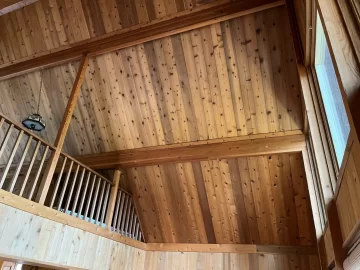

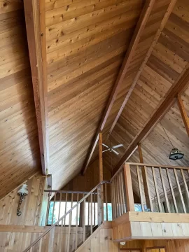

Last winter was the first year using the wood stove (BK Sirocco 30.2) I had installed the previous spring. Was great and really enjoy the stove. Only issue I encountered was I lost a lot of heat up into the ceiling and loft. Ceiling in the living room is 21ft from the floor to the apex with a fairly steep roof. The floor the wood stove is on is 920 sq ft total (thins includes the master bath, kitchen and 2 bathrooms, with the living room portion being only around 400 sq ft with a 400 sq ft loft above. There's a small ceiling fan up in the loft, but that really doesn't do anything and would like to hang a new fan right over the living room at the apex with a downrod.
I'm trying to determine what size ceiling fan I need.
Here are a couple photos.

Awesome looking place! I have a similar home although smaller and have one ceiling fan centered just off the loft near my stairs so I can reach it. You may want to look at two fans, one in the loft and one centered over the great room.
