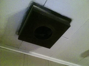

I bought an old house that used to have a wood heater and need to know if the cover on the square ceiling support box is designed to be removed. It has one screw in the front that I removed, and I can't get it to come down. I wanted to put an 8x6 reducer pipe in and use an old wood heater while we are remodeling but no one seems to know anything about how to remove the cover.The pipe on the roof is 8" double wall and 6" single wall on the heater. Is an 8x6 reducer pipe what I will need? Thanks for any help. I asked around at Home Depot and Ace Hardware but no one seems to know anything. [Hearth.com] Ceiling support box cover removal[Hearth.com] Ceiling support box cover removal
I bought an old house that used to have a wood heater and need to know if the cover on the square ceiling support box is designed to be removed. It has one screw in the front that I removed, and I can't get it to come down. I wanted to put an 8x6 reducer pipe in and use an old wood heater while we are remodeling but no one seems to know anything about how to remove the cover.The pipe on the roof is 8" double wall and 6" single wall on the heater. Is an 8x6 reducer pipe what I will need? Thanks for any help. I asked around at Home Depot and Ace Hardware but no one seems to know anything.View attachment 284669View attachment 284668
What cover are you referring to?
The square black box in the picture with the 6" hole in it. Is it removable? This is my first experience with a wood heater and it looks like a cover but it may be part of the ceiling box. I don't really know.
That is probably what is supporting your chimney. So no I don't think it is removable
Like bholler said, that box is probably supporting the weight of your chimney.
You need to identify the brand or style of chimney you have. Then you'll need a chimney adapter piece to adapt stove pipe to the chimney pipe.

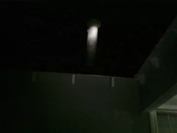

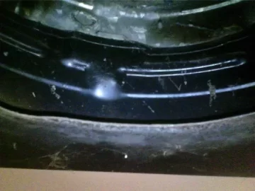

Thank you all for your help. Looks like the chimney adapter might be the answer. The house was built around 1940 so I have no idea what brand of chimney it is. I took a pic of it but it's dark out here and we are getting ready to call it a day. Thanks again...RT[Hearth.com] Ceiling support box cover removal
