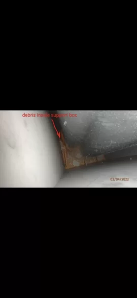

Is the ceiling support box supposed to have a cover in the attic? I had my chimney inspected and multiple fire hazards were found, it was not installed to manufacturer specifications and there was blown-insulation in the ceiling support box. The inspector said there should be a cover that came with the chimney for the box. This inspector is a local wood stove contractor who solely does wood stove installations. My installation was done by a half-ass HVAC company. Multiple clearance discrepancies too. [Hearth.com] Ceiling support box cover?

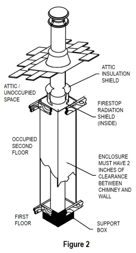

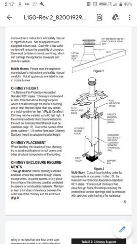

There should be an attic insulation shield with a storm collar lid. This is specifically to keep debris out of the support box. No one knows what work will happen on the house in the future or with another home owner if the place sells. Debris could fall in from roof work, insulation addition, etc. The chimney installation directions show this. This is for Duratech. a clueless inspector does not make it right.

Ah but that is not a ceiling support box. It's some sort of low rider thing. Is there such a diagram for what the OP is asking about?
Maybe I worded it incorrectly. I see it being called a collar or a shield. It gets placed on the open side of the support box. In my single story home the extended ceiling support box opens into the attic where it is currently collecting debris
Yes it should have a cover without question. Whether the manual requires it or not as you found out stuff can get in there without one and that is dangerous.

Can you pull the camera back to show the whole thing? Is this a cathedral ceiling support box? What does it look like on the room side?

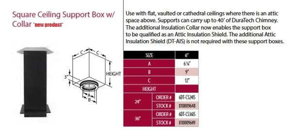

Here is another duratech manual btw

Looks required to me

Unlike the diagrams that you and bholler posted, the OP and I have single story installations where the ceiling support box is actually a couple feet tall and does not require a lid as the top of it is above the insulation level.

Gotcha. Duravent came out with the square ceiling support box with cover, but I think that was after your install. Otherwise they recommend using the DT-AIS cover because, as noted, chit happens.

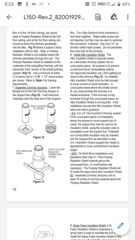

The manual says the support box can be used as an insulation shield but it needs a cover. It is pretty clear.
The storm collar and the cover for support boxes are pitched pretty hard for a reason. It keeps stuff from sitting ontop of it. Honestly the biggest problem I see in the field is mice or squirrels in the attic putting stuff in there.
They need to be covered leaving them open is unsafe.

Regardless of whether it is required in the manual or not I have seen way to many mouse nests or acorns in support boxes to ever let one open.

Read the manual I posted a link to. It is required now clearly. It may not have been when you did yours but it is now.
And how will a mouse make a nest above the insulation shield? How will squirrels pile acorns there? I guess bees could.
This is a clear safety issue that every chimney system I have used addresses. And a really simple and cheap one to avoid.
