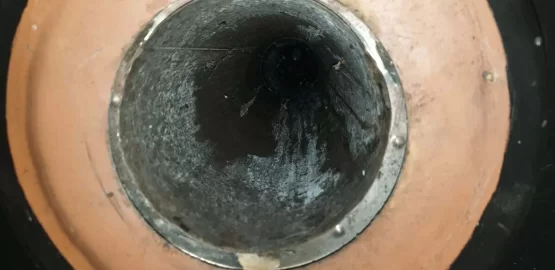

We are looking to buy some 6” double wall stove pipe to hook up a new stove but have no early idea what brand ceiling support box we have in our home.
After looking online for visual matches we thought it may be a "Deluxe Ceiling Support 6" (TGDLXS)" from Metal-Fab. But their people decided it was not a match due to it not having a crimped portion of flue pipe extending down. I’m half tempted to buy the Metal-Fab Temp/Guard pipe adapter anyways as it looks so close to my eyes but hearing it’s not their product is making me second guess that choice.
I hope someone here can recognize the shape or the internal connections as at this point I’m not sure what else to try.

Looks like it might be Security, but I am thrown off by the brown bottom plate.. Usually, there is a coupler attached. Is that on the old single-wall pipe?
Can you post a picture of the chimney cap?

Have you been up in the attic to see if there's a label on the upper portion?
Unfortunately the upper portion of this is behind a wall on the second story. I did try getting into the attic to see if I could look down at it but the space looks pretty closed off (see pic). I am considering taking down drywall to expose the upper portion as a last resort though.

That looks like a really good match (with the exception of the brown you mentioned). I'll send them a message to see if they are able to say one way or the other. I've attached a new photo that may help explain the brown. Uneducated guess: It looks like the part I had moved to the side is maybe there to install the coupler, and the smaller black cap is "after market" and was meant to cover the hole after the coupler was removed?
I'm not sure what the previous owner had hooked up to this before but a local chimney sweep has said it's 6" double walled. (He also guessed it was a DuraVent product, but I haven't been able to find anything by them that matches.)
I can't get onto the roof (pitch is too steep) but will try to take a photo from the ground when it's light out tomorrow. I'm feeling pretty positive about this Security Chimneys identification though. Thank you both for your help!
