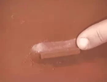

FYI, engineering is MUCH more important than thickness when it comes to boilers.
I saw old Tarms which were made of pretty thin (approx. 1/8) steel which were 60+ years old (at the factory).
As with much design, over-building is often a way to try to make up for a lack of proper design. If the leaks are at welds, it does not matter how thick the steel is!
My advice - buy an engineered product. That means designed by engineers and built to standards. ASME is a great standard, but so are some European standards which apply to their boilers.
A layman would be VERY impressed when you see what goes into a ASME pressure vessel. Every piece of steel, welding rod, bolt, etc. has to be traced from start to finish and also treated a certain way right up until it goes into the product! Welding, in general, should look better than a caulk line you could lay.....or, it should look (and sometimes is) like it is done by a robot.
I have enclosed a screen shot from my tarm video of some nice Tarm welds.....

Some of the other obvious things (to welders, at least) is that steel should overlap as in those pictures - the steel sticks out enough to provide lots of surface area for the weld...it seems better than a butt joint, although these cannot be helped in certain places. These welds, btw, are the outside of the water jacket! I would expect the ones in the firebox have to stand up to more abuse!
Craig - outstanding! Yes, engineering and intelligent design are what constitute a quality product that will last. In Central Boiler's case, the 1/4" thick plate would have given me more years before the material failed like it did, but you're dead-on when it comes to welds. Thanks for the reply and great website!
ASME stays must protrude on both sides of the pressure vessel(approx 1/2" past the weld) otherwise they don't pass. Not to be discounted is the high quality steel that is typically used in Swedish area products. On Ebay they just put a coat of paint on the old tarms & the're ready to go again, Randy
