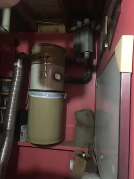

That is interesting. I have a 240 VAC unit for more power with dual exhaust and it sounded like a jet plane not to the liking of my neighbor. So I just put 2 mufflers made for the vac on the exhaust pipes and now everyone is happy except when I have to dig my sock out of the canister when it accidentally gets sucked up! LOL
  • [Hearth.com] Central Vac Yea or Nay?
