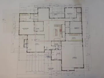

Tell us more about the house layout, window areas, fireplace location and ceiling heights. If you have a plan or a sketch of the floorplan that shows the fireplace location and where heat needs to be ducted to, that would help;

Here are the plans (still a work in progress, but will be very close to this). Sorry for the poor quality...
[Hearth.com] Century Fireplace Furnace
The imgur image just shows as black. It's better to post the image itself.

Can see the image now. What remote area(s) would need ducted heat?

I would like to duct heat the entire home (including the basement, minus the garage).
