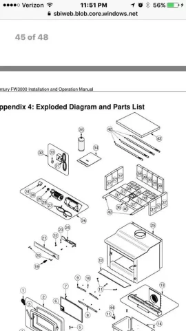

Recently purchased a used CH FW3000 the cast baffle in it was toast [Hearth.com] Century heat FW3000.
So here is my question either I buy a replacement vermiculite baffle from SBI for $70 or have seen where some of you have built a baffle from fire bricks. What would you guys do? Do you put the insulation blank back in on top of the vermiculite or fire brick. Thanks for the help guys.
Does that baffle contain the secondary air system? It does on my little Century.
Mine has a hollow steel baffle that is part of the secondary air system. The back part of the baffle is made of firebrick.
I think I would use a vermiculite baffle in your case. I'd probably lay kaowool along the edges in order to keep as much smoke flowing over the tubes as possible.
Interesting. Mind me asking you to explain your thoughts on the kaowool along the edges? SBI discontinued the blankets on their more recent offerings. I ask because I feel like I could get more usable heat out of mine, and considered using a blanket to slow down the flow up the chimney.
