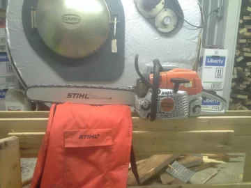

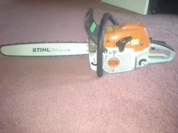

Brand new on pink carpet at Grandpa's house.
Used saw in my Garn room.
