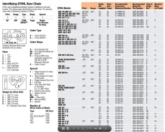

This may help

Thats what i was looking for, thanks guys.
At $11 dollars each to have sharpened ill just keep for the extra dirty wood. Besides 2 of them was "professionally" sharpened once before and they took off way to much and removed almost all of the rakers because they aid it cut faster that way.
I just wanted some new chain now that i finally can put a good edge on one with a file.

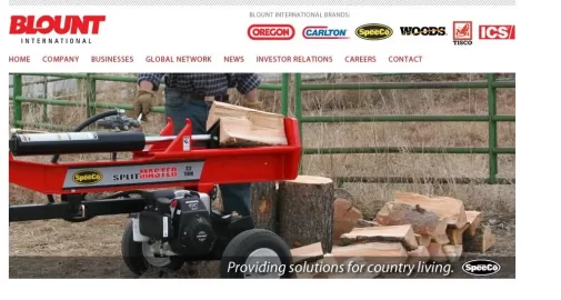

Oregon & Carlton have the same parent Company.
http://blount.com/ :
" Blount Inc. produces saw chains, bars and sprockets that are well respected in the chain saw and forestry industries and outdoor equipment accessories and parts for the garden and landscape industry. Blount
these products under the brand names OREGON® and Carlton®."
