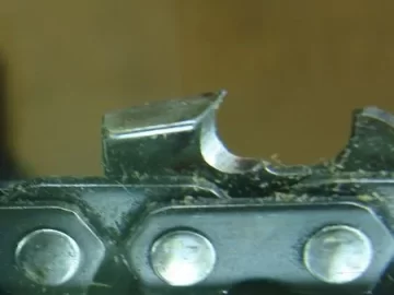

What exactly are the rakers?

they are the the thing that sticks up in the air between the cutters and they clear the way for the cutter to do there job!
the raker is to the right of the cutter
The bump-like things sticking up from the chain that are before and after each shart 'cutter' tooth. They serve to limit the depth of the bite that the cutter can take so the saw doesn't bog down, and also 'rake' chips from the kerf. If you keep sharpening the cutters and don't take some of the rakers the chips will be thiner & thinner, production will drop.
Ahhh thanks guys! So do you run the file just across the top of them?
Jay, is that a full chisel chain? I keep seeing them on some big saws.
yep round ground and hand file rakers.When I do rakers I like to round them with a swoop to the left.(if your looking at the pic)
