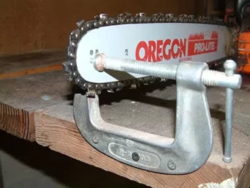

I'm gonna go down into the basement in a moment and take a photo of my top-of-the-line, state-of-the-art filing vise and post it here.
Here you go....
I've got a couple more pics showing how to file both sides of the saw more or less equally with a vise like this, but will start another thread with all three shots.
