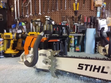

Come on Dexter, nobody keeps their tools hung up and runs a saw with with a worn out bar like yours!:)
Gary
8 pin on my 046 with a 20" bar, is a really nice combo. I also run the 8 pin on the 064 at 24" with skip chain. Does well for me.
Gary
I keep telling you guys, Dex buys His firewood, & polishes His saws for pics. Is that bench carpeted? A C
Appears it is!....... and it's cleaner than my living room carpet :eek:
