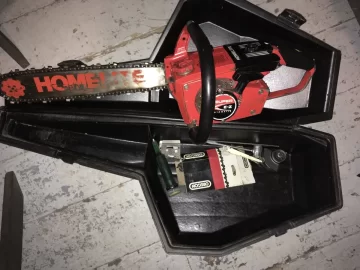

so, pulled apart the Poulan since i could not get any combustion at all. so far, i like the way this saw is constructed. not sure of the year range.
anyway, pulled the top off, and noticed the fuel line was off the nipple. touched it, and it broke apart! totally aged. opened up the gas tank and emptied the gas. the filter was rolling around, and the brittle line was in pieces.
so, clearly the problem is fuel! now will have to locate a fuel line and maybe new filter. is this just a generic situation?
i think this can be a nice 14" vintage saw once fixed.

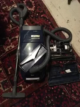

1) nice kenmore vacuum. nice condition, just needs a new rug attachment belt (probably why they tossed it!). i don't know why people through away nice working vacs. i've actually picked up several really nice kenmore over the past couple of years and passed them around. all work nice, some with heap filters. we all need an extra hearth vac!

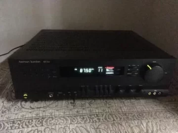

2) harmon kardon stereo receiver. pretty nice mid-90s vintage. gave it a surface cleaning, hooked it up, nice sound. thankfully it wasn't raining today, or this would be unsalvageable. i've grabbed three 1990s receivers over the past couple of years: this, a yamaha, and an onkyo. i understand, they don't have wi-fi, bluetooth, hdmi, etc. still, come on people, stop trashing good stuff! who doesn't need some tunes while stacking those 10 cords of firewood!

90's receivers are usually better than what you can get for reasonable money now. When we moved into our current house we found an electrolux vacuum about 25' into the woodline... People don't know what stuff is worth sometimes.
belt for the kenmore arrived. popped it in, vac works perfectly. i like canisters much better than uprights.
