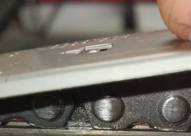

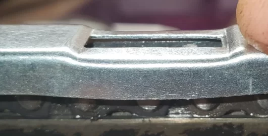

Check that your bar rails are square. Fast way to check if the rails or chain is flip the bar over.

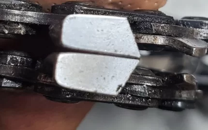

If you are using fixed-depth raker adjustment, your tooth length is probably different on one side (file down the other side to match). Common filing error.
If you are using progressive depth raker adjustment, it's more likely to be a raker issue, as tooth length doesn't matter near as much. Make sure you are checking and filing the rakers the same way on both sides of the chain. Adjust tooth lengths to match the low rakers on the low side.
Also possible that it's the bar, but 9.5 times out of 10 the novice issue is fixed raker depth and uneven tooth filing.
A grinder would absolutely not fix your problem. With a grinder or a file, the first step is to know what a good chain looks like (keep a brand new one onhand if you want a physical reference to look at). Most grinders, especially cheap ones, tend not to cut both sides the same length by default- it's up to the operator to make that happen.

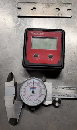

I suggest you get some calipers- you can get some basic ones for $5 or $10, which will let you find the shortest tooth. I suggest spending a little more- This one is very good and not too expensive. With the better calipers you can put numbers to all your measurements, and it has the fringe benefit of being good for other stuff (like never again wondering what size a screw is).
For now, flip a chain around and hold a left side cutter back to back with a right side cutter and see if they are the same or not.

Top to bottom, FOP-style progressive gauge, digital angle finder, dial calipers

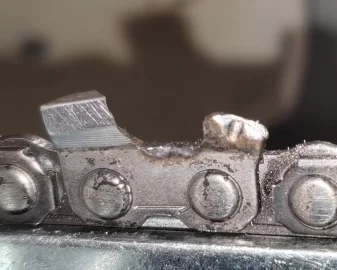

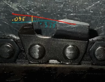

I can't find a good picture on the internet, so here's a real life example from my workbench.
Here's a fairly new cutter with most of the tooth length left.
The old 0.25" raker gauge says this raker is way too low
A FOP progressive says it is just about perfect, maybe a hair low

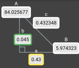

The calipers say the tooth is .505 high and the raker is .480 high, a difference of .035.
The calipers also say the distance from the tip of the raker to the tip of the cutter is .375.
Here is the triangle formed by the tip of the raker (yellow), the tip of the cutter (red), and the wood being cut (green).
Solve the right triangle to get the angle of attack there. A new chain generally bites at 5.7°.
So that raker is .035, and making a 5.3° angle to the wood.... lower than a factory chain at 0.25"!
I put the digital angle finder on it and got 5.5, so close enough.

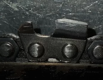

Now add some wear to the tooth.

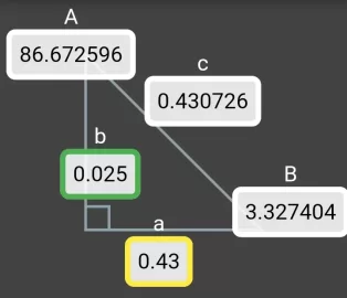

Now the tooth is .490 high, the raker is .445, a difference of 0.045. It is 430" In a straight line between the point of the tooth and the top of the raker.
So 5.9° , this raker is about perfect.
If this depth gauge was set at 0.25"....
We'd be cutting at 3.3 degrees and making tiny chips and sawdust.
The upshot is that if you always keep your rakers at 0.25", you will be cutting at around 2° at the end of the chain's life- barely any bite!
Here is the triangle formed by the tip of the raker, the tip of the cutter, and the wood being cut. (I did the wrong color in the picture, .375 is the green line not the red one).

Now the tooth is .490 high, the raker is .445, a difference of 0.045. .375" In a straight line between the point of the tooth and the top of the raker.
So 6.8°... this raker is actually a little aggressive but not bad enough that I'd file the tooth back to fix it.
We'd be cutting at 3.8 degrees and making tiny chips and sawdust.

A real simple way to get most of the way there is to use a fileoplate type progressive gauge- they are not perfect but they are real easy to use.
If you ever want to accurately check how your hand filing or depth gauge system is steering you, grab a pair of calipers and measure like I did above!
Like I said, the pole is at 5.7° because that's how they get ground at the factory, but maybe you have a smaller saw with a bigger bar cutting oak, and maybe 4.5° is going to work better for you. Maybe you have a titanium chain and a custom saw made out of an old motorcycle, and 10° will get 'er done faster. :)

My experience. Filing is only part of the issue. With a new bar and chain, if you get the filing off a little bit it will still cut straight. Up to a certain amount of wear. Then even a tiny bit of inaccurate filing will make it go crooked. Then it gets to a point where no matter what you do, it cuts crooked. Even with what looks like lots of tooth life left. That's because the other side of chain is wearing, along with the bar groove. Chain is sloppy in the groove and won't stay upright. When it gets to that point, time to start new again with both. For me. Sometimes a new chain will tighten things up enough, but most cases here, both are worn. Should be able to get 2 or 3 chains worn out with 1 bar, but trying to prolong bar life can lead to frustration with crooked cutting.
(That could likely all be lessened by cranking an adjustable oiler up. If you have an adjustable. The 250 is not.)

I got a 2x72 belt grinder for making knives last year
Bonus was it is great for dressing bars,you can get right in close to the sprocket tip with it.Makes truing the rails an easy task.Then a vice to squeeze the rails back together if they have got sloppy.
And then you have a bar that cuts straight and is good for a bunch more chains.
