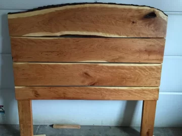

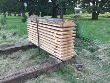

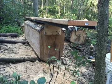

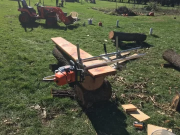

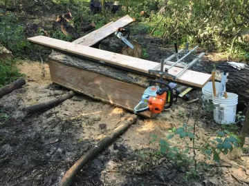

I started just to do a few boards 3 years ago with an Grandberg 36" mill . Then I had to buy a bigger saw, then a planer, a roof only shed for the drying area and now I have stacks of boards drying for upcoming project I hope to get to someday. I already made a cherry headboard and am now ripping and planning some oak for the basement trim. Cool thing is I have 2" slabs of cherry and elm for future tables or whatever I end up doing with it. Pretty cool to have unique wood slabs you can't buy.
