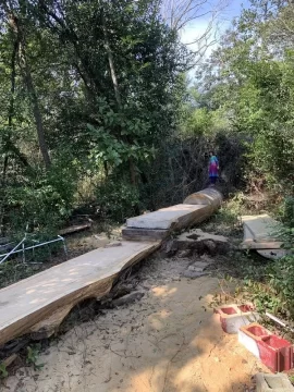

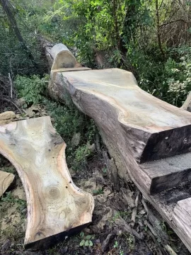

Others with more experience may have different thoughts but from someone who’s has milled 1/4 of a good sized tree here are my thoughts. Chain is chain it all gets dull and needs sharpened. Some seems to be harder than others. I have two Carlton loops (36” and 52”). First cut was amazing with both. This was 11’ long and 28” minimum width. Next cuts were less impressive. My freehand sharpening skills were not up to the task for the first few times. and I have since got a file’n’joint. Has gotten me smoother cuts. I made a loop with regular (not ripping) semi chisel Archer full skip chain. It worked fine but left the finish rougher. I have since changed the top plate angle to 10 degrees so it’s now a full skip ripping chain but have not got to use it yet. I am going make up another loop for my 28” bar. Good sharpening is more important than brand of chain.
to seal endgrain I have used two coats of leftover latex and anchor seal. Anchor seal seems to be better but I may have just gotten into some better wood when I switched to it. Sun is the enemy. Really any thing that speeds up the drying can lead to more warping in my experience.
Not sure what your plans for the wood are but I have been using green for various projects as I just need to get stuff done and out of the way and have gotten away with it with anchor seal on the ends and a paste wax or clear poly.
Evan
