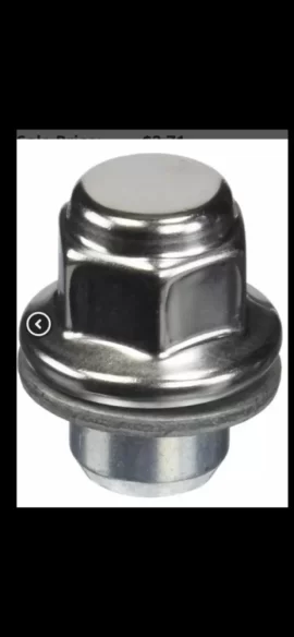

Thank god but see pic of ripped lug nut? I cannot put that back on! Also had to bang the lug nut out of the impact socket on the bench vise!

4. Distorted and torn wheel lug after finally removing it with breaker bar and Maddox impact removal socket
5-6 New non OEM wheel lug nuts for Toyota from Pep Boys $7.99 for set of 4

I'm pretty sure your OEM lug nuts have decorative covers. That's why you had a hard time.

Oh yes, I never knew they had decorator covers! That is how they got warped and the tire wrench would not fit properly!
Do you know if the aftermarket lug nuts have them??
The OEM lug nuts were $5.18 each! I certainly did not want those!

I was just talking to the local Toyota Dealer Service Manager and he said the humidity gets into the OEM wheel lug nuts with the decorative chrome covers that all the manufacturers use nowadays (That explains the title of this thread!) and makes them swell and also can make them rust inside! Nothing more reliable than the old lug nuts that you are using! Good idea! 👍

My Toyota Service manager said the lug nuts that enclose the top of the stud are the ones that swell.
My 2000 F350 has the OEM black lug nuts that seem to have an washer with teeth and then a seperate attached nut that you torque but spins over the washer. Are these the ones that swell? I've never had a problem with them, they are over 22 years old.
He also said they do last for many years and keep dirt and water from getting on the studs to protect them. :-)
Like this below.
