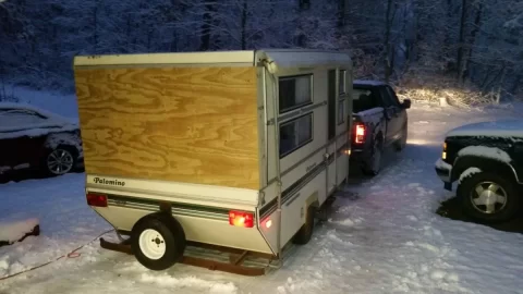

I am taking my char griller 22424 side fire box and turning it into a wood stove for my pop up camper ice fishing shack. What size pipe is recommended and what would I need to do it? I am looking at 4" diameter or 5" diameter pipe. The floor to ceiling is about 6 to 7 feet high. Thinking of running it out a window or building a shelf in the front by the tongue of the trailer which would site about 3 feet off the ground.

I have both sides walled up, side walls have windows with screens, there is a propane furnace in the but it seems like the propane isn't getting to the furnace or stove. Neither will light. So figured I would use a small wood stove to heat it. Also has side vents for the furnace and a vent on the roof.
I think you'd likely be better off fixing the furnace. Probably just a bad regulator or pilot.
There will be holes put in this weekend and it will go out on the ice once as the ice is about 12" or thicker. I might look into a propane heater adapter that goes on top of a 20lb propane tank or maybe a wall mounted one that I can run a propane hose to.
I just realized I overlooked that neither stove nor furnace will light. I'm thinking it's a crushed (or cut) line, bad (or incorrect regulator) or bad tank. There's usually nothing between the regulator and the stove other than pipe. If the stove won't light there's not much else it could be.
Decided to return the Char Griller 22424 and ended up buying a Dyna-Glo Dual Fuel Blue Flame Vent-Free Wall heater. Has a Thermostat and:
  • Oxygen Depletion Sensor shuts down heater if oxygen were to be depleted
https://www.farmandfleet.com/produc...al-fuel-blue-flame-vent-free-wall-heater.html
Much better idea. Even though they are vent free I would recommend a wall vent (floor register) installed near where you are going to mount it. I would still get the CO detector.
I was going to suggest that but then remembered there will be a big hole or two in the floor for fishing.
