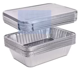

This is interesting. I like how it gases off and makes use of the heat, like secondary burn tubes, and you're making charcoal. I wonder if you could use the cheap aluminum baking pans with lids to do it as well. Aluminum melting point is 1220 degrees, the fire wouldn't get anywhere near that. The aluminum pans are not nearly as durable, but you can buy 10 times more of them at half the price.
I don't think one of those would survive. The fire gets every bit that hot in the firebox.
I guess I'm underestimating what the temps get up to in the belly of the beast.. but the concept is interesting with the hotel pans. I hate to put out money, to later find out it's a novelty approach. I need to think about what I have on hand for a couple trial runs.

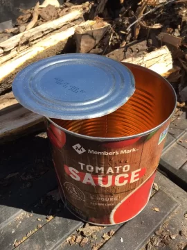

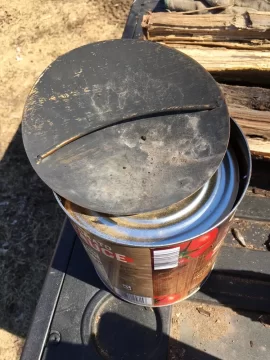

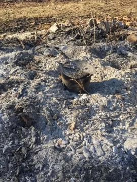

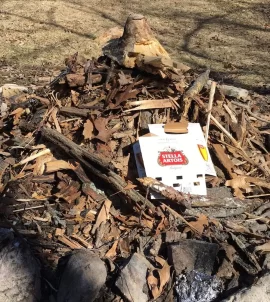

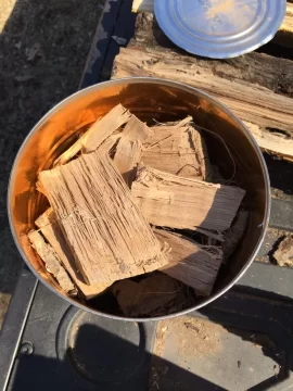

My outdoor fire pit has been building up with log splitting waste to the point I needed to burn it. Then an idea hit me, I need to burn a pile of wood waste, and I have chunks of oak all over the place. All I needed was a metal container to put some oak into and bury it in the middle of the wood pile. I stumbled across some 16 oz. food cans, with the tops cut off in the cans. I crammed some oak chunks into it and put the cut off top onto the top of the oak, then I placed another piece of metal on top of that. I buried it and let it burn, this morning and I have mostly charcoal. Some of the bigger pieces in the bottom were blackened but not really charcoal.
For a quick throw it together at the last moment attempt, it went well. Next time, I will get more fire under the can.

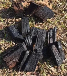

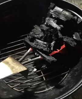

I cooked some burgers over the lump charcoal I made a few days ago. It was a learning experience, I think that was my first time cooking with lump. It worked really well, it cooked hot and fast, you have to keep an eye on it. The burgers had a smoked oak flavor. The successful first trial has received approval for another round of grilling.
