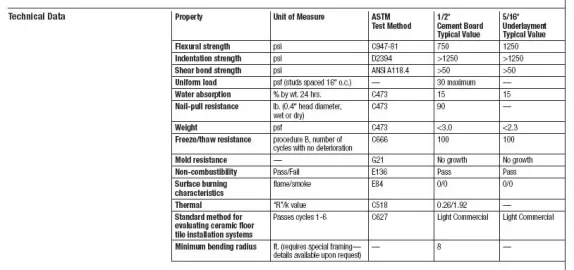

I will have to disagree and state than cement board like durock or wonderboard has a decent R-value relative to other options. It is cheap to buy and very available. Easy to work with. There are members on this site that have stacked 6 layers of the 0.5" durock to get the required R-value.

Just to clarify, Durock cement board is rated R .52 per inch. It's often uses to build up R value in a hearth. However, as noted, the T6 just needs ember protection. Any non-combustible surface will work fine, be it sheetmetal or cement board.

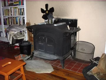

All depends on the stove. Our cat likes to sleep under the Alderlea. It just gets cozy warm under it.
I purloined a good large river rock from a secret stash of such in the Mountains of NC, somewhere near... oh, never mind.
It's been flawless the last three winters. There will be another for the second VC soon.
Camera at work, but I'll post one tomorrow.
Finally got a shot... 16 year old chocolate lab, Breton, moved behind the couch to cool off.
Shot froze spinning Stirling fan in mid spin. Stove running at 490F and climbing.
Rock came from Davidson River, in the vicinity of Brevard, NC.

Thanks for the pic.
I was thinking river rock(s). I'm considering making a frame on the floor under the stove and filling it with river or beach rocks as Craig suggested in his 1st reply.
No more dustpan and brush. Just shuffle the rocks around and let the crap fall through to the bottom. lol
One rock covers it here. I'll be looking for another larger one soon ;)
