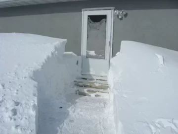

That is how it gets here where I live.
This mornings walk about.
We don't get a lot often but 18" one night in December of 2009 and three feet in 24 hours in 2010 was enough for me. You guys can have the stuff as far as I am concerned.
