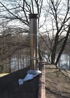

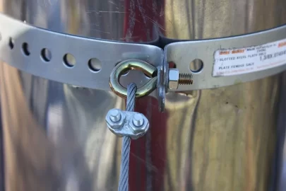

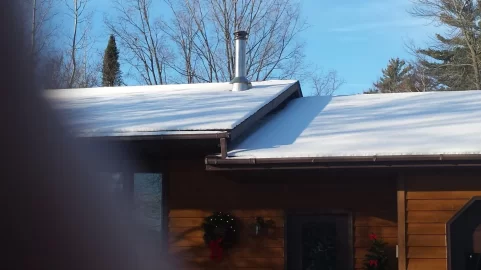

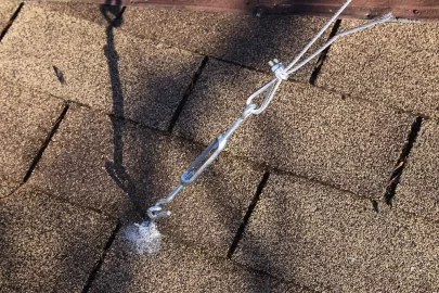

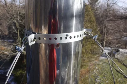

If you don't want to pay the high price for the chimney mfg bracing, here's some photos of what I just did. My chimney was 5' 6", so bracing was required by code but not really required for strength. I already had some 3/16" aircraft cable, the bolts, etc, so my only cost was about $10 for the metal strapping at HD. I formed it into 3 sections to go around the chimney without any tools other than pliers and vice grips. You should only need to have adjustment on one of the cables but you can do all 3 if you really want to. The cable ends still need to be taped. I ran out of time that day.

Thanks for the reply, ideas,and pics. My situation is a little different in that I have less than 5' on top of the roof, so I think I will try to come up with a more rigid brace of some type just beneath the roof ( to replace the existing plumber's strap ). It is very helpful to see what you did as I can incorporate some of your ideas into a plan for my bracing of the pipe. I may be over thinking this but it seems like it should be more secure than it is currently.
