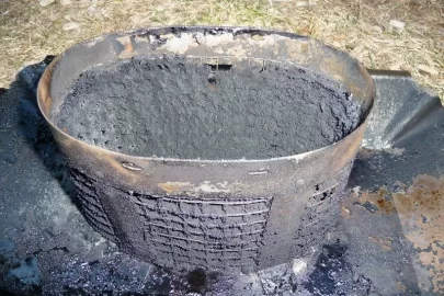

Chimney Cap Caught Fire Tonight.
76ER
Nov 30, 2007
80
Southern Ontario
As the burning season comes to an end I have been only lighting the stove up at night. Tonight I didn't change the ritual except for the really dry kindling the neighbour gave me. Strike of the match, light the paper and off outside with my beer. I looked up and saw an ember come out of the cap..then another...then a sizzling sound..a very loud sizzling sound...I rushed inside and closed the bypass damper and the air control..the stove responded and went black...I went back outside to witness the stainless steel screen that keeps out the little birdies, glowing orange...it did so for about 10 minutes...I opened the air input after this and the stove came to life...the cap and screen remained quiet...I might just have the chimney sweep remove the screen (he put it on)c Cheers all!

I hear ya on the cap being more of a problem. I hadn't had my stove going for about 2 weeks. The other night i wanted to light it and take the chill of in the house. As i got the fire going, i herd stuff falling in my chimney. I was just up on the roof days before to take Christmas lights down. The cap was pretty clean. So i herd the crap fall down don't know what it was or if it could be bad so i just the stove down and cleaned it the next day. Come to find out with all the warm weather and rain we had made all the junk that was on the cap loose and all fell down to the bottom of my tee. it wasn't a while lot, prolly would have been fine, but for as long as it takes to clean i just cleaned it. the chimney wasn't even that dirty 3 cups full. i would like to cut the screen out or get a different cap or just take it off for winter. If i took it off for winter i don't want rain coming in and laying the bottom of my SS tee. I was wonder if anyone has every had a fire at the cap.
Two years with a cap and mesh screen (albeit large mesh screen) and no problems . . . of course burning seasoned wood and burning at proper temps and cleaning the chimney regularly may have something to do with the zero issue deal.
It doesn't matter how well seasoned your wood is. Doesn't matter how good you are at burning it. Those screens will plug up long before any accumulation is deposited in your flue. The only exception to this that I've seen is the occasional cat stove burner.
There is nothing good about a cap screen. I also wonder what value a large screen has since sparks are pretty small. Even with my spark screen removed, the largest hole in the simpson cap is way way smaller than an open flue.

Just took this photo. The cap has not been touched since it was installed in 2006. Over 9 cords of wood smoke have gone through it. I'll be pulling it this summer for inspection and will take some close up shots then. Dry wood is good.
PS: stove has a nice fire going in it now, started an hour ago. Love how there is no smoke.

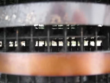

When it clogged, it happened very fast. My fault - first year in this house so wood is not perfect. The flue was pretty clean. Just need to get up there and clean it more often.

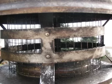

I've never had a problem with my chimney cap and I burn all sorts of wood, some not so perfectly dry, 2x4's, plywood & osb scraps, white paper, newspaper, small cardboard boxes, brush - basically anything that will burn that is not too toxic I use to light the stove. I sweep 1X per year and I have never had a problem. I think the key is to run your stove hot. I burn as high as 600-700 pretty much everytime I run the stove.

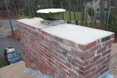

I have been told to remove the screen, but I figure it is there for a reason, so I kept it. I was amazed how much gunk was around it when I did go to clean it. This was after 1 year. Stove was installed 1/09. Cleaned it 12/09. The wood was not ideally seasoned, but it was the best I had. Same cap as BG, simpson.
Heck that looks downright clean. You should have seen it before the spring and summer rains cleaned it up for ya.
Chimney caps collect crud. Ya ain't gonna stop it. Mine without screens used to have a pile of sote laying around the base when I would go up for the mid-year and the end of season cleanings. It would collect under the top of the cap and then fall off on the top plate. When there was nothing but fine soot in the pipe. Just be happy you don't have a single wall outside chimney. The whole inside of the pipe would be coated with the stuff.

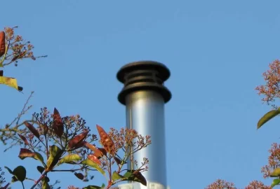

I had not seen this thread before posting my question about caps and draft, but in looking at the pictures, and watching my own cap in action, it seems to me at some point in every burn cycle smoke is lifting and being almost contained at the cap. If there is no wind at all, smoke just kind of rolls around and out up there. I can see the need of mesh for critters, and there has to be a height restriction lest angled, driving rain get down the flue.
I think I'm going to try and configure some kind of cone with a hole at the top, like a tee pee. Keep out rain, but also allow smoke to ascend and escape more easily, rather than trapped in a confined space.
Unless you have a screen that is clogged, a cap is not affecting the draft as much as you think it is. What you have is a draft problem.
Even with the cap off, I bet the smoke still will just roll out. You can try and build a better mouse trap. But in the end, until you address the draft problem, your tippi is going to do the same thing.
Based on the web page I looked at (from ye ol' web master), there is definite difference in some caps and how they work with various winds. No cap at all leaves the charts. But you have rain and critters to deal with, so caps are invented. They are not all the same. So, yes, I think there's always room for a new mouse trap.
I have no draft problem. Whatever draft problem may have existed has been corrected with a liner and another foot and half of flue length. Though I have not noticed any great differences in stove performance as a result. But I have noticed a difference between the cap I had on the chimney and the cap that came with the liner kit, and how the smoke escapes.
