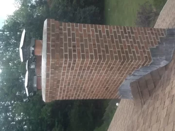

Chimney cap cover...and cover
NHcpa
Feb 16, 2014
592
Honyock NH
[Hearth.com] Chimney cap cover...and cover Any reason I can't cover over the pellet cap with the former mesh cover like the other two? I also see the chimney cap install is lifted up and the install guy simply filled with silicone...nice job...
During the burn season you dont want mesh on the exhaust because the ash precipitates and will eventually block it. I use 1/4" in the off season and then pull it off during burn season.
