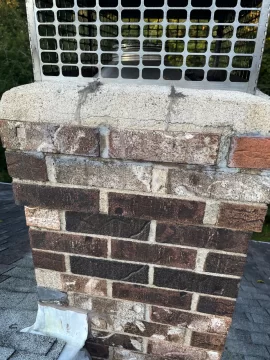

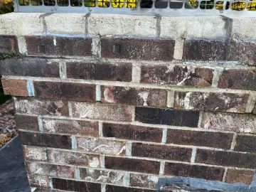

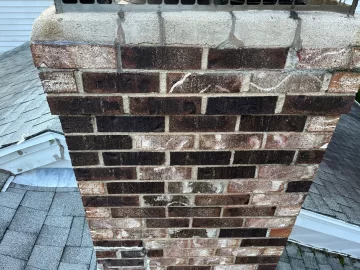

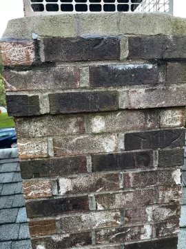

I’m looking to repoint and get a new Chase cover for his chimney. Looking for thoughts on how much a stainless chase cover would be for it. Two flu set up one flu from my 6 inch chimney liner and the other for the 8 in.² clay that goes to the basement.
I also know the chimney is in need of repointing . I want to put up some pictures to get thoughts on if this might be able to wait a year or if it looks like it needs it sooner than that.
Also, I wanted people‘s opinion on if repointing is a reasonable DIY project. I’ve never done it before, but enjoy learning how to do new things and how to do those things well and correct. That said, I’m also wondering if the new stainless cover is also a reasonable DIY project.

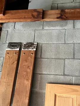

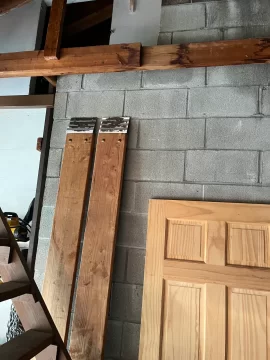

I wanted to add to my posts with a couple of pictures. This is of the back of the chimney that is located in the garage. The two blocks that are near the rafter look to have a spot on each. I’m wondering if this is a sign of moisture getting inside chimney/a.k.a. time to re-point immediately. I actually have a picture of this part of the chimney from nine years ago and the spots were not present.
For reference, I know that there is a darker spot as well to the right of these two blocks, but that is staining from an old flashing problem that we inherited when we first bought the house and has been fixed at this point.

It the tarred "Z" on the exterior face of the chimney on the same side as the darkening showing on the cinderblock in the garage?
I’m not sure what you mean about the tarred “Z”. Im adding the pic of the exterior side of chimney that corresponds to the back side of chimney in the garage down below. I had put some silicone on some hairline crack in the current crown, but not sure that’s relevant to what you mean.
Ok, I think I know what you mean about the tarred “z” now. That was from an old flashing job. Had chimney reflashed about 4 or 5 years ago and no noticeable leaking in garage since then. That “z” is on the opposite side of chimney from the spots I noticed in garage.

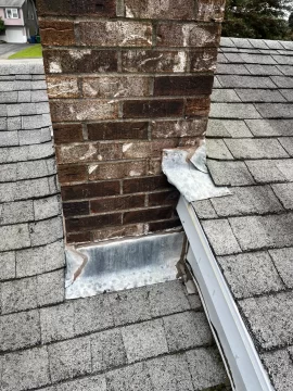

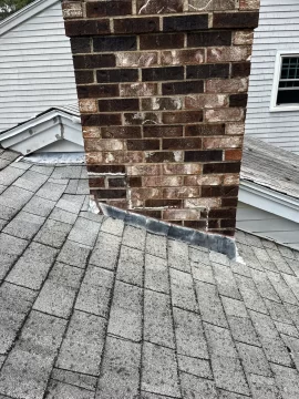

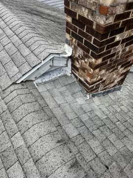

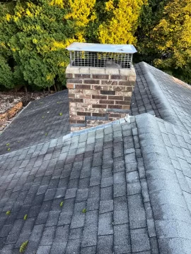

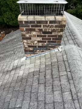

OK, got up on the garage and took some better pictures of the flashing. I’m not sure if it’s in the picture, but when the chimney was flashed, the person put a “cricket“ in the trouble spot on the roof so that that part of the roof could shed water better.
I’m no pro on how the flashing is as far as quality, but I do know that the obvious leaking that I could see prior to the flashing job as I can see from inside the garage had stopped after the flashing job.
I do know that I’m definitely getting to be due for a new chimney crown and probably repointing of at least some areas of the exterior part of chimney.. was curious if people could give me an idea of how immediate this should get taken care of. I’d like to go with a stainless chimney crown because I suspect that would be a lot less expensive than a poured concrete one done properly. I’m also wondering how much of this I could do on my own. I’ve never done masonry work to be totally honest, but I’ve seen some videos and I’m not afraid to learn new things. ImJust not sure if I’m totally getting in over my head if I were to try to refresh most of the exterior of the chimney on my own. Thanks for any input you might have.

That flashing job is amateur at best. Step flash/counter flash is the standard and they didn’t get any of that right. You can see the previous location of the counter flashing, it’s the zig zag of roof tar.. 🤦🏻‍♂️

Ok thanks for the input. Next heavy rain we get, I will see if there is any noticeable leaking. I have the advantage of being able to see all 4 side of chimney from the garage area ( small loft space gives a small view of the chimney-enough to see if there was a leak.
Aside from the flashing being sub-par, I was curious about stainless chase covers to accommodate my wood insert and 8 inch square clay line that not in use). Is this a reasonable DIY project ( easy access to chimney from garage) or is it tricky enough that a pro should be hired? Thanks

OK, we got the very heavy rain today that I was looking for to see if there’s any noticeable leaking around the roof line from the chimney. In spite of the heavy rain this morning, things look to be dry as a bone, so perhaps the flashing job stinks, but is effective at least for the time being.
Enough caulk will seal up anything 🤣 but hey good news for you! We did get about 4” in a short amount of time here as well. Not the driving type of rain though, hopefully that doesn’t screw with your conclusion.
