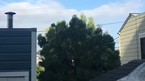

I currently have this type of chimney cap, and my neighbor says the smoke comes in her window. Hoping to avoid having to add an extension.
If I was to change this cap, is there one that would direct the smoke upwards?

No. You have a neighbor problem, she won't ever be happy unless you stop burning. Sorry for your loss.

What stove are you using and how are you running it? The cap has nothing to do with if the stove smokes or not
I'm a new burner, so yes, the smoke is probably due to my lack of skills. I bought a house with a Lopi Answer-95, and had it cleaned when I moved in. Replaced the door handle which was stuck and put in new door gasket, and everything else seems to be working fine. I love fires but burning in a wood stove definitely has a learning curve. I've been reading and watching videos and welcome any tips.
We can't burn around here when its a poor air quality day, unless its the only source of heat. It doesn't get super cold, but it is very damp and the stove helps dry out the house.
Thanks for the information regarding the chimney cap and previous help regarding the flue extension. It'll save me a bunch of money if I can just learn the smoke-free fire technique .

Raising the chimney pipe a length might help. Try top-down starting the fire. That can have less smokey starts.
