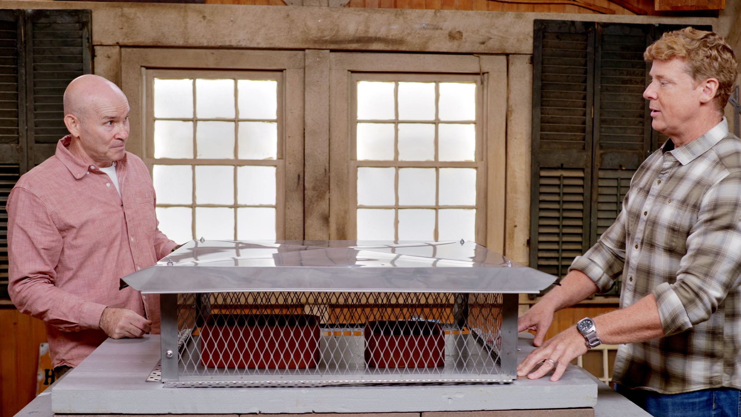

Newbie here. My friend has always wanted chimney caps on his two chimneys, so I built two out of heavy gauge steel and heavy angle, and mounted them. Within a month he noted that creosote was condensing and dripping down his nice metal roof.
These caps have a roof design, are about 16" x 30" and weigh about 65#. one of them spans two flues. The roof sits 5" above the base, and i wonder if increasing the height of the risers would somehow keep this from happening?
Any ideas?

It's inevitable as unburnt wood gases hit a cold plate of steel or stone that they will condense as creosote. The shed roof will cause this to drop to either side.
So, that's the case with all caps? They all condense and drip? YUK.
Increasing the height of the roof ? how about inverting the roof so it condenses and then runs down into the flue? Crazy enough to work?
Raising it will help but not eliminate the issue. More efficient burning can reduce this but water vapor and volatiles are a byproduct of wood combustion. Most caps of this design are flat roofed, using stainless steel to reduce and slow down corrosion.
Tell him he needs to burn drier wood.
Yes, an inverted baffle inside guiding the drips down into the flue might help a bit as well.
Flat roof...good idea. He gave me a cap with the peaked roof from another source, so I modeled it after that.
I could cut out the middle of the roof and weld in a flat section....yes, I have seen images of flattish caps with just the outer edge pitched down...
