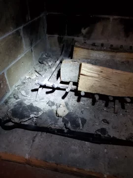

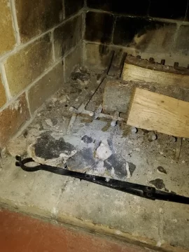

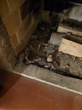

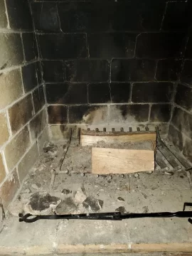

please see the attached picture, this is what falling down on the damper, the way I understand, mortar is supposed to be between bricks. But this looks to be something else that's falling.
I looked up in the chimney with a torch and looks like it has terracotta liner but it is not all the way through. Terracotta liner is maybe max 4-6 feet long and just on the top part of the whole chimney. After that, it looks like cement all the way till bottom with a heavy of Creosote deposit. Looks like previous owner never had it cleaned. Damn this old house, everything I try to do in it, is a fight.
From the look of it, it maybe that cement that's is what falling down. What you think?

That just looks like old parging material. No big deal and the firebox looks fine

Looks like old lime mortar. My old house is brick and I fix plenty of it. Clean that chimney so you don’t ignite the old creosote off the new liner, or have to smell it smolder, and be aggressive to knock anything else that is loose down.
