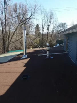

if at all possible, would it be best to take the chimney apart? I have an encore 2n1, so i was going to pull the cat out, and was going to go top-down. I picked up a rutland poly brush and 18' of rod. I don't mind getting on the roof, but wasn't sure if I would get it cleaner if I disassembled the whole thing?
i've never cleaned a chimney before....
no you should not take the chimney apart unless it is totally necessary. Yes you should pull the cat out and clean it. As far as top down or bottom up it doesnt matter it is which ever is easier for you. But going on the roof always carries some risk which is why I avoid it when possible.
my roof is pretty much flat, so that is not a problem...
do i twist the brush, or just move it up and down?
more people are seriously hurt falling off of flat roofs than pitched ones you get a false sense of security. And usually just up and down is fine.

being a former roofer, I am familiar with people falling off of flat roofs!I have plenty of clearance, but will make sure to be careful.
And there is nothing wrong with doing it from the roof but every time you go up there you are at risk. Which is why when I can avoid it I can. But as long as you are carefull and aware of the dangers you will be fine. Especially since you have allot of experience on a roof

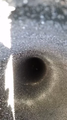

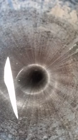

i cleaned the chimney yesterday, and it went pretty smoothly.
This was the before. [Hearth.com] chimney cleaning system?
this was the after.[Hearth.com] chimney cleaning system?.
I couldn't quite tell exactly how much buildup was in there, but it felt like it was about 2 cups.
