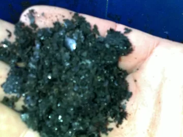

So the shiny stuff is worse? It does look like coffe, and it just crumbles up. Here is a pic... Not such a good one.

The creosote in your picture looks like mine, except I get a range of different sizes from coffee grounds up to big chunks... Black, and very brittle, the chunks will crush and break up easily....

Seeing the pic . . . I wouldn't worry too much. I pictured things worse than what they seem to be.
