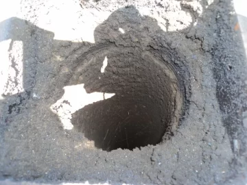

When I first looked at the chimney, I thought that it had a lot of creosote at the top.

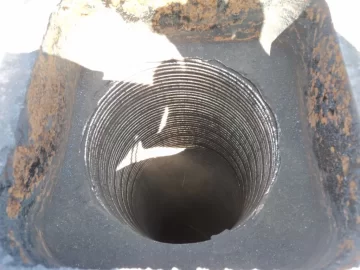

This is the picture after running the brush through.

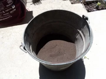

I felt a bit better when I scooped out all of that junk at the bottom.
[Hearth.com] Chimney Cleaning
Probably a bit more than many on here get but fairly consistent with the last few years.
Yeah I went the whole season instead of doing a mid-term cleaning this year and that is pretty much how mine looks. But I ain't going up there this week in the cold rain. ;hm
Bart you're right about that! I did mine on Sunday when the weather was nice. We're gonna get a lot of rain over the next 24 hours!
Cold and damp/wet here too. I came home from work and fired the stove up. I cleaned mine 2x over the winter, ran a brush down through but the last month or so of burning I wasn't burning the best wood so I will do it again good here soon
