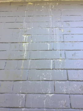

Last fall I painted the exterior of my house including the chimney and have noticed some sap like substance forming on the outside and running down the chimney. Could this be creosote?
I'll try to get to posting a picture tomorrow when there's some daylight.

Please post a close-up pic if you can get it safely! It definitely could be creosote from what you are describing....

Here are a couple pictures!

looks like bird poop to me :)
Reactions: sportbikerider78
Yup. No issue!
Well yes it is an issue it shows that there is water getting into the structure in some way. It is either getting in from the weather rain snow ect. Usually either from a cracked crown or bad flashing. Or it is coming from condensation from a failed or mis-sized furnace flue.
Good point.
