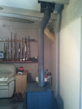

Whoa- what are you saying, you only have a flue pipe, tell us what you got.
I think I may be using the wrong terms or im posting on the wrong page.
this is what I have.
[Hearth.com] Chimney Fire
So you have a flue going up to class A pipe which is a chimney. So you have the very same thing that most of us have so the discussion works for you.
No problem, I edited my post to reflect that is what most of us have so you have the same concerns we all have.
The pipe going from the stove to the support box is called the "connector". It can be single or double wall pipe. The pipe above the support box and through the roof is the "chimney" and must be class A high temp pipe.
