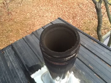

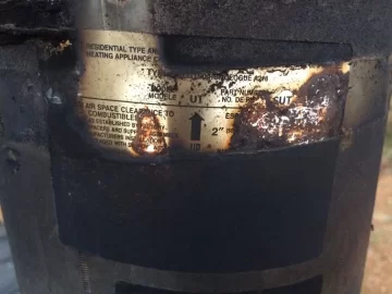

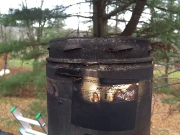

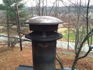

I just thought of something else when considering adding exterior pipe- Will I be able to tell what brand of pipe i have? i.e., i haven't gotten on the roof to check yet, but there is an existing 3ft section. I'lll need to be sure that i'm using the same Class A brand. Can one tell by the connections? The chimney cap appears to be either a metalbestos or supervent cap, so I'm guessing the pipe is one of those two...
you can take a picture of the pipe and either post it here or compare it with other like pictures on the web or send it to a chimney pipe vendor.
You also may want to replace what you have and get better pipe if you find the case comes up that way.
I'll snap some pictures tomorrow morning & post them up
So I was able to put a flashlight on the labels of the pipe & was able to make out Metalbestos (I think) [Hearth.com] Chimney height question/thoughts[Hearth.com] Chimney height question/thoughts[Hearth.com] Chimney height question/thoughts[Hearth.com] Chimney height question/thoughts
Yeah, that looks like Metalbestos...
