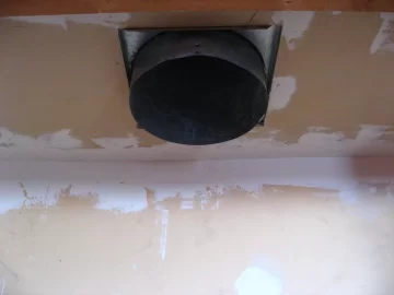

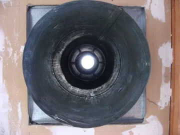

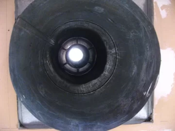

  1. What class/kind of chimney do you think this is and can it thermally support a wood stove?
  2. The lower section of pipe fell from the chimney during demo. Can I slide it in from the bottom or does it need to be dropped from the top?
  3. I need to connect a double walled pipe from the wood stove, 6" diameter, to this chimney. Can this be accomplished with an adapter (13.5" OD on the chimney pipe)? or do I need to run all new pipe out?
Thanks
[Hearth.com] Chimney Help [Hearth.com] Chimney Help [Hearth.com] Chimney Help
I cant be sure but that does not look like ul103ht pipe i think you need new. But look for a label and we can chack for sure
what was being vented through it before? Lighting a fire inside your home is no place to cut corners if you are not 100% certain replace it. Or at least I would.
