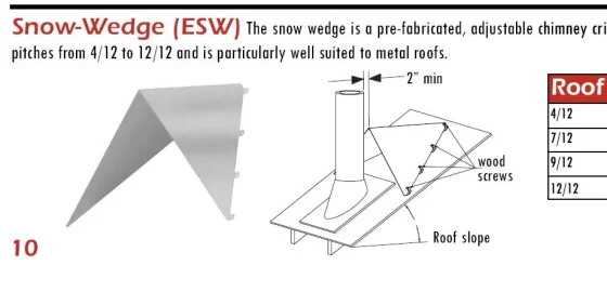

you would need to use a Cricket/Snow wedge to devert the snow away from the pipe.

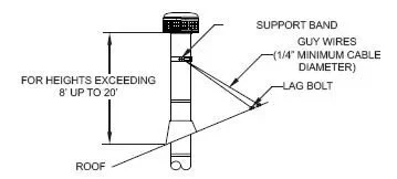

Here is a pic of the proper installation for your roof.

Well, I think my questions about the chimney height and location are answered; how about this next one - If I follow the construction diagram above (reply #5) and my chimney is 12ft tall, will I need two support bands and cable ties to the roof? Or would one at the 6ft level be sufficient? If two, can the cables anchor to the roof at the same point?
Thanks again,
-JD
If you do ONE ridgit type brace like the photo I posted will be fine
but if you are in a snow area i do Recommend a Crickitt/ Snow wedge.

Ixnay on the snow wedge. Don't waster your money.
